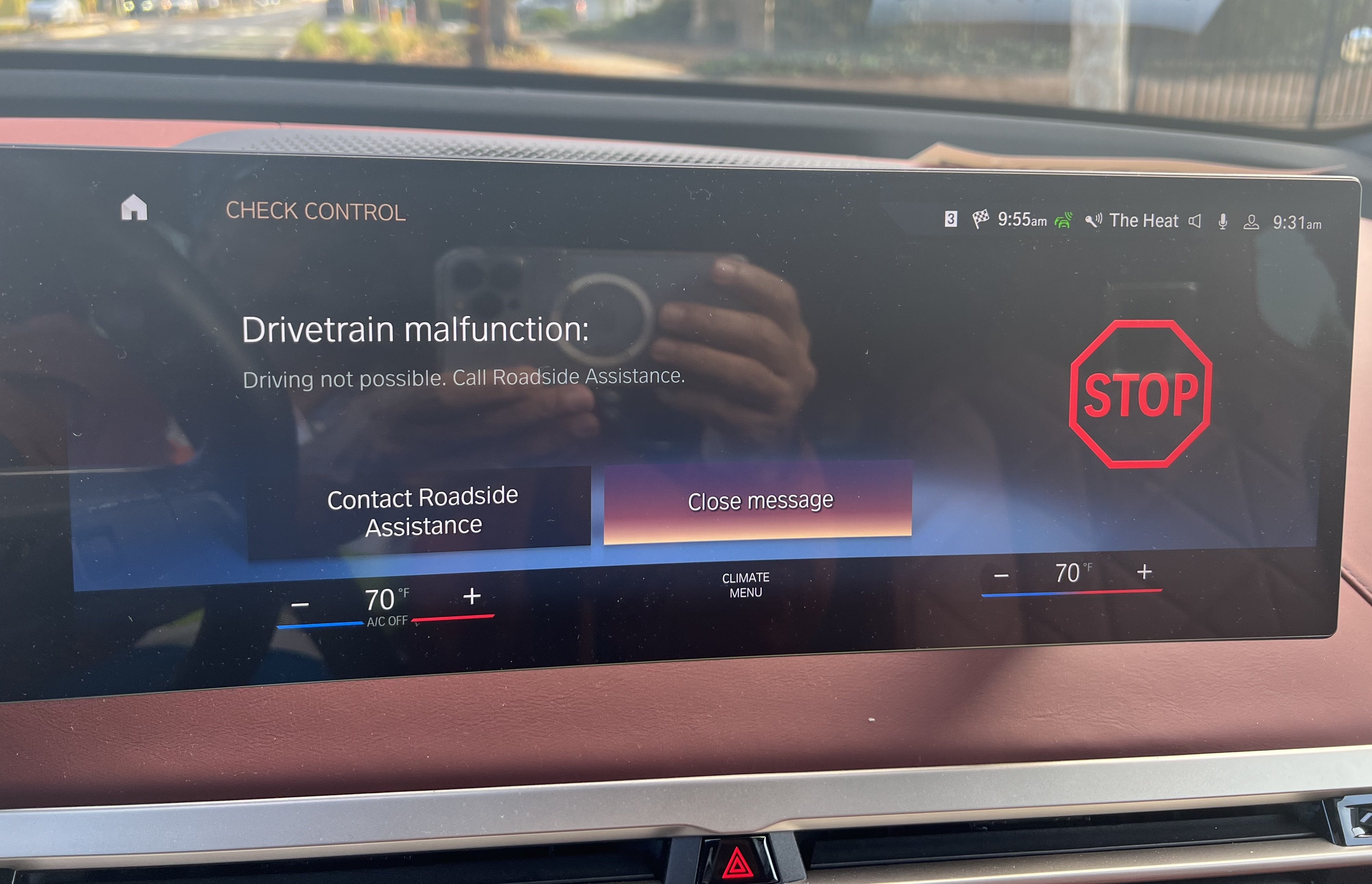

Hello,
I’m really disappointed with my new BMW IX 2023 purchase. The car stopped on the road with the drivetrain malfunction. The reason I did not buy a Tesla, but instead a BMW was for the quality expectation. Alas that did not turn out to be the outcome.

BMW just increased the time for the towing company. I have been standing by the roadside for almost 2 hours. BMW has really horrible roadside assistance! And btw, I am in sunny California and it is 70 degrees here so no weather issues. Perhaps more iXs are breaking down and bmw just needs to contract more towing companies.

Yikes. Was your car built in October? Mine was and I just found out yesterday it's one of the iXs that was on the "stop delivery" advisory. It's supposedly a drivetrain issue but no one is getting any information at all. My dealership's service dept. knew nothing about it when I inquired about another matter yesterday and they discovered this for my VIN. I guess we're not using this car over the holidays, especially not after today's snowstorm. Aargh.

I got my car 3 weeks ago. So might be the same October batch. Dealer mentioned that they had 2 i4 and 3 iX with the same problem. Looks like this is a global issue. It is nice and sunny and warm in the Bay Area. Was planning to hit the slopes of Tahoe driving the iX which won’t happen. Dealer did not have loaners - do you believe that.

IX50 delivered in march 2022, now has 5000 miles on the clock. Recalled once for software update on November. Received Drivetrain warning while driving to family on Christmas Eve so called assistance. BMW tech came and run diagnostics and 'couldn't identify the source of the error'. Drivetrain error remains on dash. Advised to drive back to BMW garage or have car collected. While driving back on December 26 car generated a high voltage battery warning with immediate instruction to stop. Called assistance and tow truck collected car. Next repair slot January 16. Loaner offered cannot be used to drive outside the UK. So Xmas and new year holiday ruined. BMW need to fix their software issues, their lack of available techs and their loaner policy.

This one isn’t the issue mentioned by PhiliX. I had that one happen too, but that’s just for when the NAV system says no media connection or something like that. The drivetrain one has happened to me too. It happened on the freeway. Luckily I was OK. The towing issue is not with BMW but the local towing companies and the priority of their calls. BMW couldn’t get a tow to me but I went ahead and towed it with AAA and they reimbursed me over $1000 for it. Once it got to the dealership they did a software update and that took care of the problem. They said it was a known issue in San Luis Obispo. BMW also offered to Uber me 90 miles to my destination for free. My daughter decided to drop everything and come get me. Guess she figured she owed me that. It was very sweet.

Had the same 2 warnings two days after I picked up my new iX M60 on 12/13/22. Returned car immediately to Service center, after diagnosis, BMW main ofc advised SC to replace the coolant pump for the batteries. It’s now 2 weeks later and was advised vehicle will be ready today. Keeping my fingers crossed that the issue is now resolved.
