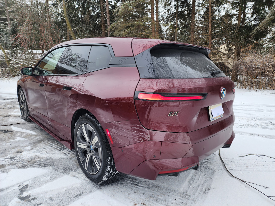

Finally got my M60 Dec 8th and decided to add a few things.

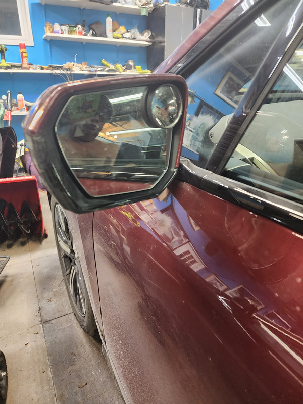

The first thing was adding 2" adjustable convex blind spot mirrors.
I like to see what's in my blind spot and have been using blindspot mirrors for 40 years.
I turned off the lane departure assistance because it kept vibrating the steering wheel every 30 seconds at 70 mph.
Although I almost always wear my seatbelt on the public roads there are times aound my properties it can be annoying.
Since you can't turn off the chime in the menu I added a seatbelt extender to turn it off.

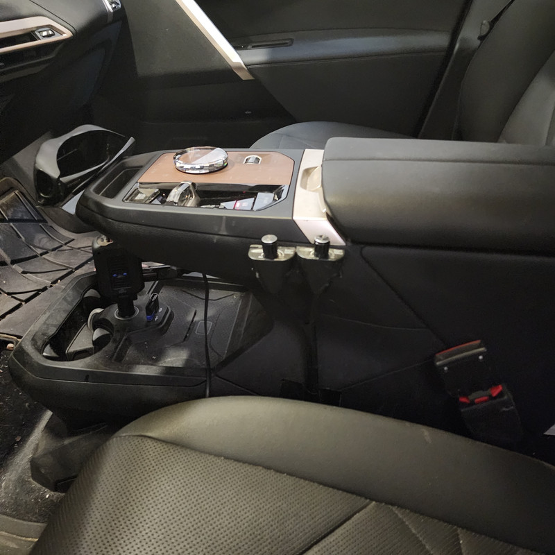

I added a cup holder since I don't like the oem cupholder location
Hooked my V1 Radar detector to the console ACC port for now.
Eventually I'll hard wire it to the fuse panel here
Using an Add a Fuse

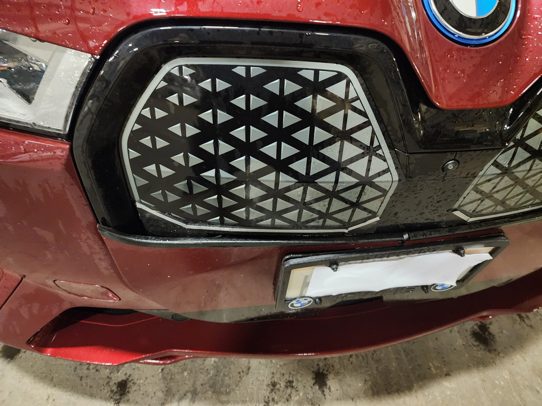

I also sloped the front plate down so it reflects radar and laser towards the ground.

Where did you get the cup holder? I have ordered 1 or 2 and they do not work. I returned them.
#3 · (Edited)
Amazon
I drilled a hole and with a 2 inch space tied it off with some wire to the seatbelt buckle after my coffee cup went flying during a hard stop.
I also added a blue led I plugged into an ACC splitter for night driving to make it easy to put the cup back without fiddling about.

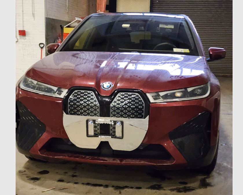

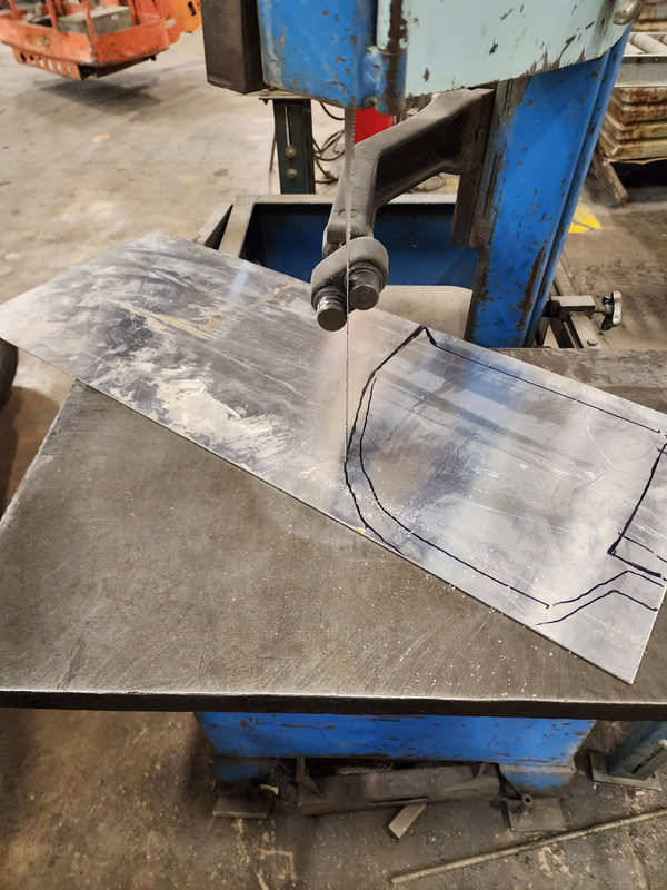

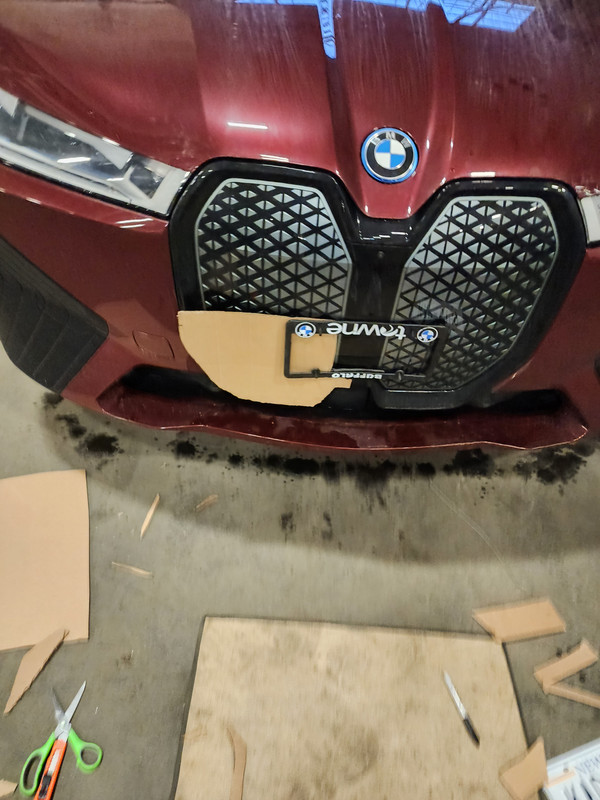

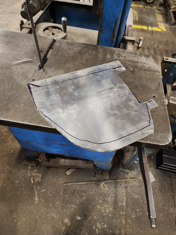

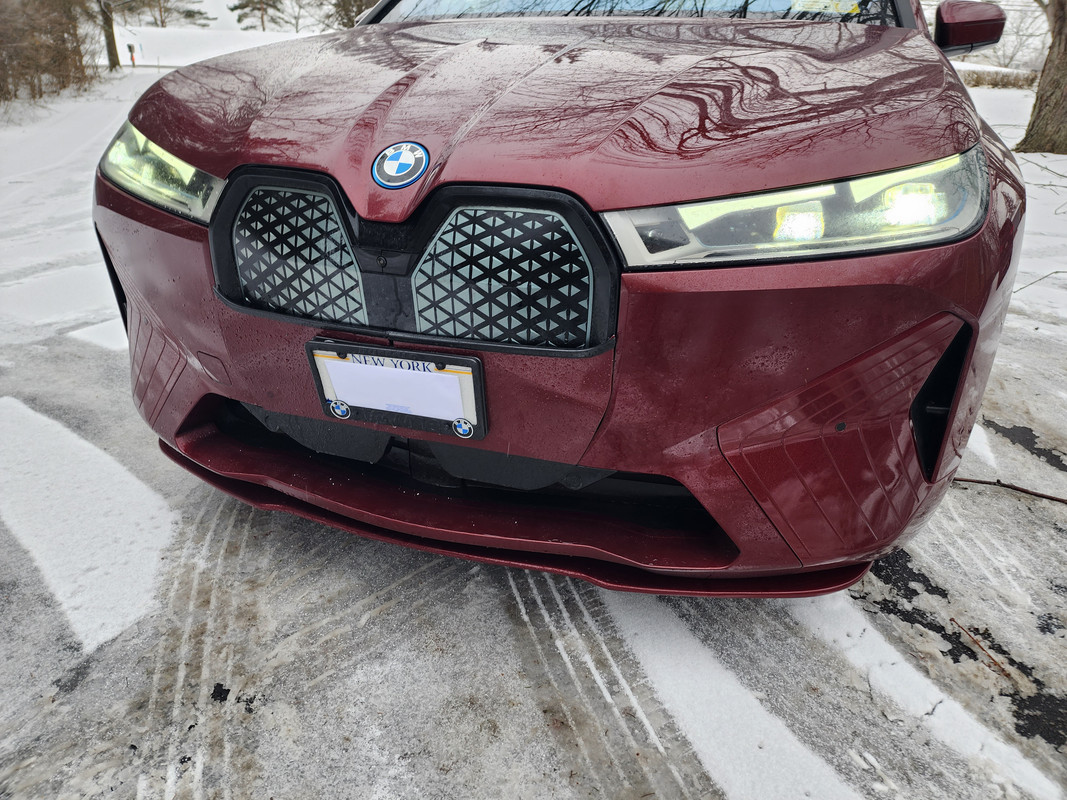

I got this urethane one on ebay and made it work
I used some thin checker plate from Home Depot

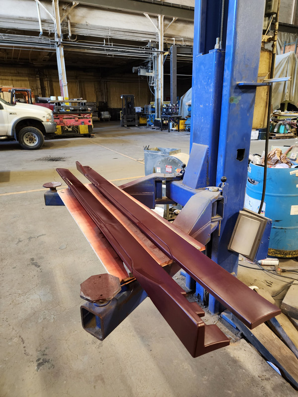

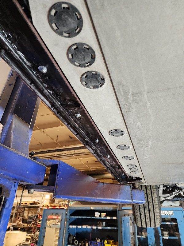

No good quality skirts were available except these craptastic 3 piece plastic ones from China
I re enforced them with some 3/4 abs waterpipe

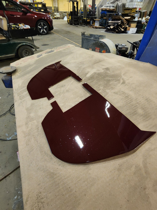

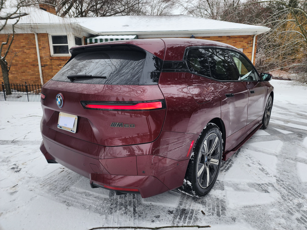

My grille mod is completely removable as are the skirts and IMO the car looks better with the black parts painted the color of the car.

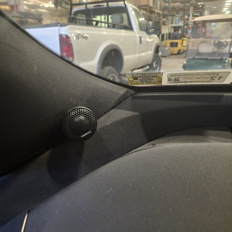

I was also not impressed with the B&W system with the meager under seat subs and no tweeters up on the dash for depth so I added 2x 12s and tweeters.
Now I've decided to add Midranges and an AL Priority Laser Jammer
