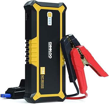

This is all great information. A gentleman who was charging his Ioniq 5 next to me said to always have a set of good jumper cables with me. I said "What? Are you serious?" He said that EVs have 12v batteries that if they go bad or lose charge, the EV will not be able to do anything. So I guess it is true.
My question is now, where is the 12v battery in the IX? My guess is under the hood that BMW doesn't want us to open. Lots of questions come into mind now, but that would probably be for a different post altogether.
#20 ·
Yes, this is actually super important with all EVs. The Ioniq 5, in particular, had an issue where the car would discharge the 12V battery and strand people. So all of the I5 captains should have one. But they are key equipment for every car, not just EV.
I have one of these; it is super popular among the EV world.
No clue where the iX's jump points are - I guess I should figure that out...
