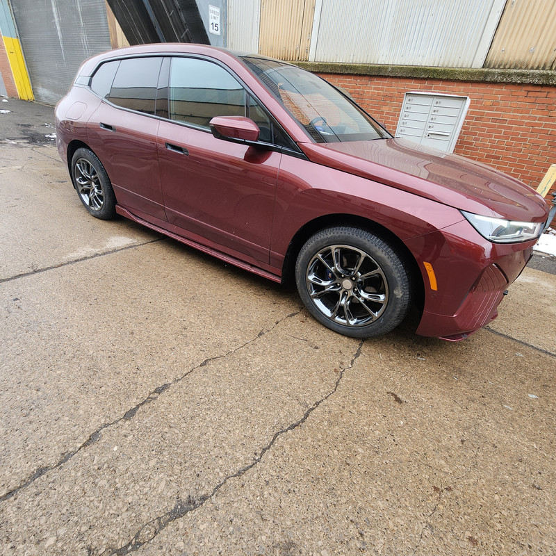

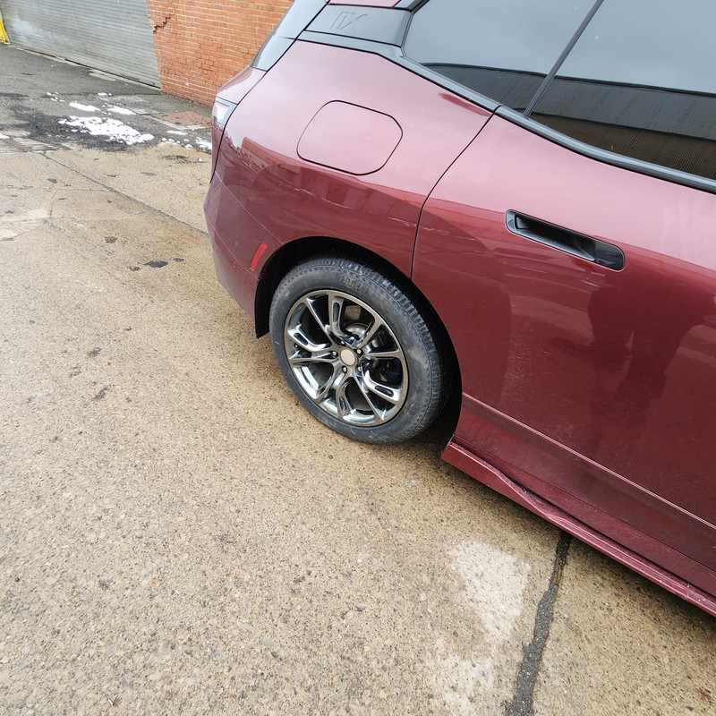

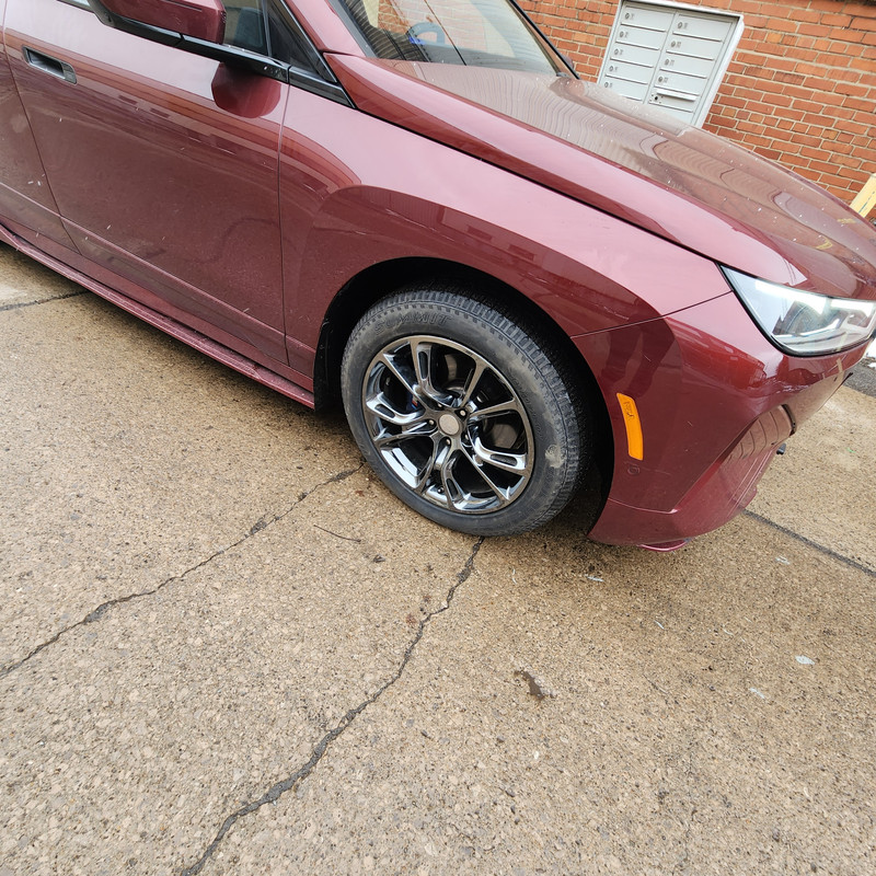

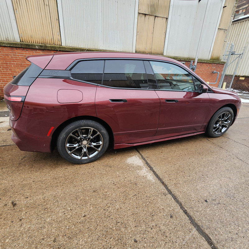

I had a set of 2014-16 20" black vapor chrome OEM Jeep SRT wheels I put on my M60.
The tires I used were 265-50-R20 V rated for 160 mph which matched the height of the 22" wheels
in the menu and only cost $520.00 for 4.
